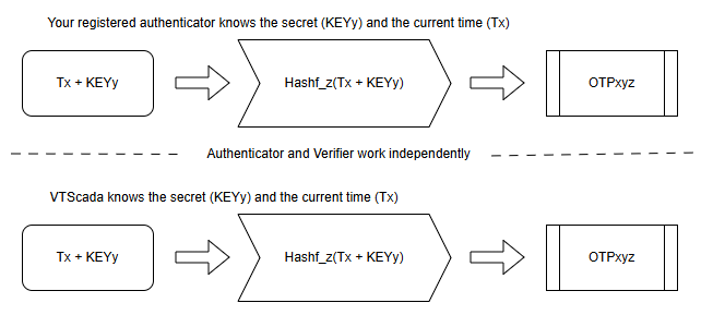

TOTP makes use of a simple algorithm to enable two isolated machines (like a cell phone and a workstation) to independently generate identical passcodes.
By going through the registration process, a secret known by VTScada is shared with the registered device. Each generated secret is random and time sensitive. VTScada only displays the secret at registration time for 90 seconds. After the secret is shared, the user must enter a time-sensitive one-time passcode from the device they're registering. This guarantees that the secret was successfully shared.
At this point, the VTScada application and the registered device share a secret. The secret is combined with the current time and both machines use the same secure hashing method to independently produce an identical 6-digit time-sensitive one-time passcode.
Using the same secret, same time and same secure hash method, your device and VTScada expect matching passcodes.
