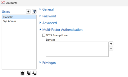

Registering or Removing Devices as a System Administrator
You can register a device on behalf of a user (You will need the physical device in hand). Click on your username in the title bar and go to the Accounts menu. Find the account under "Users" and click on it. Under the section "Multi-Factor Authentication" you will find a box labeled "Devices" with [+][ - ] buttons. Click the [+] button to begin the process.
The other sections have been collapsed for the sake of clarity
Just like a typical TOTP registration process, you will be prompted for a Device Nickname and then presented with a QR code to scan with the device. After the code is scanned, you must type in a code from the device. This guarantees that the device has successfully registered the secret.
To remove a device, click on the device in the "Devices" list and then click the [ - ] button.

How to create exemptions for specific accounts
There are a few rare reasons to exempt an account from two factor TOTP. The more exempt accounts you have, the less security you have. It is a Worst Practice to exempt administrators or super users. TOTP will work for users or workstations with unreliable or no access to the internet.
To exempt an account, go to the Accounts menu. Find the account under "Users" and click on it. Under the section "Multi-Factor Authentication" you will find a check box labeled "TOTP Exempt User". Check to enable and exempt the user. Don't forget to apply the changes.
