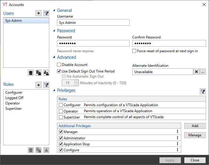

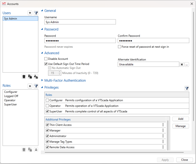

Features of an account:
It's easier to work with one section of this dialog if you minimize the other sections.
General section
Realm: Only if realm logins are enabled. Identifies the user's realm.
Username: Identifies the user.
Password section
Password: Used to authenticate the user.
Force Reset: When creating accounts for operators, it is standard to require that they change their password on first sign-in.
Advanced section
Disable option: Prevent sign in without deleting that account.
Alternate ID: For installations that include the Alarm Notification System. The numeric password they will use when signing in by phone.
Default sign out time period: Set between 0 and 720 minutes if the default time period does not apply to this user. Zero means no automatic sign out.
Privileges section
Roles: The "job descriptions" that apply to the account.
Privileges: Additional rights specific to this one account.
Recommended practice is to assign privileges to roles, then assign roles to accounts.
A sample Accounts dialog after the first account is created.

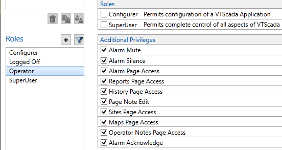

Default privileges for the Operator role
The predefined roles:
Privileges associated with the built-in example roles.
Role Privileges allow...
Logged Off Nothing. Logged Off is a special role, defining the privileges in effect when nobody is signed in. You cannot assign this role to accounts and cannot delete or rename it. You can grant privileges to this role, such as the ability to view the alarm page, but be very careful.
Operator Acknowledge and mute alarms. View all of the VTScada system pages.
Create and edit page notes.
Configurer Operator plus all privileges required to create and configure an application
SuperUser Configurer plus security configuration privileges. All VTScada privileges except Thin Client Access, Remote Data Access, and Modify Types, which must be granted explicitly.
