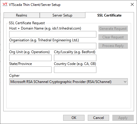

  1. Click the SSL Certificate tab. The dialog appears as shown.
  1. Enter the host and domain name in the Host + Domain Name field.
    The name you supply must exactly match the host + domain name supplied in the URL used to access the VTScada Thin Client Server. For example:
myserver.trihedral.com
Where, "myserver.trihedral.com" is the host + domain name, "myserver" being the host, and "trihedral.com" being the domain name. You may also use a wildcard, if applicable to your situation:
*.trihedral.com
  1. Enter the name of your organization in the Organization field.
  2. Fill in the remaining identifying fields.
  3. Select the cipher you wish to use for cryptography from the Cipher drop-down list.
Note that there is normally only one cipher ("Microsoft RSA SChannel Cryptographic Provider (RSA/SChannel)") available for selection, unless you have installed a custom cryptographic package.
After all fields have been entered, the Generate Request button becomes enabled.

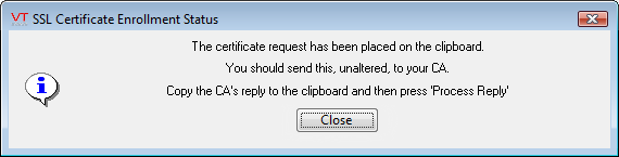

    VTScada compiles the data you've entered and displays the following dialog:

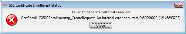

If the request failed, the Enrollment Status dialog will display an error message:
