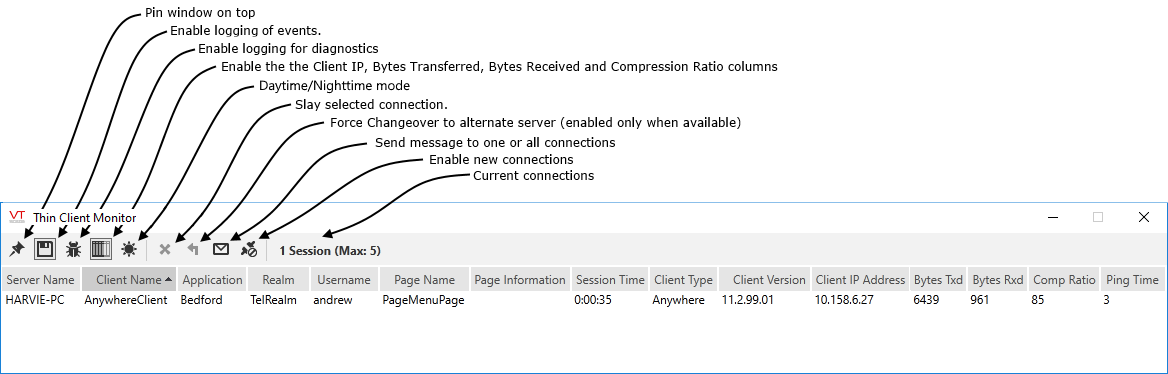

Thin Client Monitor display
If the Thin Client Monitor application does not appear in the VAM, you may have to add it. The application directory for the Thin Client Monitor application is named "BrowserMon" and is stored in the VTScada installation directory.
You can sort all the columns in ascending or descending order. Click on a column title to sort by that column - the first click will sort the rows in ascending order and the next will sort by descending order. An arrow appears beside the column title to indicate the sort order.
Controls:
| Button | Function |
| Event Logging | Enables connection event logging. The output file is stored in the VTScada installation directory as "VICMonitorLog.txt". This file contains the logged data as comma-separated values. |
| Diagnostics Logging | Turns on diagnostic logging for subsequent VIC connections. Should you experience problems with your VIC connections, this log may help engineers at Trihedral Engineering Ltd. discover the source. Refer to notes within this topic. |
| Detail | Controls whether information is displayed for the Client IP, Bytes Transferred, Bytes Received and Compression Ratio columns. By default, detail is not displayed. |
| Daytime/Nighttime mode | Change the background to either white or black. |
| Slay Connection | Terminates the highlighted VIC session from the VTScada Thin Client Server. |
| Force Changeover | Force thin clients to disconnect from this server. If you have configured for Redundant VIC, the client will automatically connect to the next highest ranked available server as defined by the VTScada Thin Client Server List. An intended use for this button and the following one is to allow you to take the current server off-line for maintenance without interrupting any client sessions. |
| Send Message | Send a message to a selected connection, or to all connections. |
| Enable New Clients | Enable or disable new connections to this server. Note: Use of the Disable New Clients button while you are remotely connected is a risky thing to do. If your own connection is broken before you re-enable new client connections, you will have to travel to a VTScada workstation. |
| The following button is available only to the application version. | |
| On Top | Available only to the script application. The Pin button enables you to set the Thin Client Monitor on top of all other windows. |

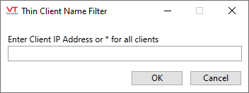

Clicking the Diagnostics button will cause the VTScada Thin Client Name Filter dialog to open:
Enter an asterisk, * to enable logging for all clients. If using the ActiveX Internet Client (VIC) the log file is named VICDiag.TXT and saved to the connected user’s My Documents directory.
If using the Anywhere client, this button will turn on communication diagnostics for Anywhere Client sessions that start after the option is turned on. (For existing sessions, refresh the browser.) These diagnostics are written out to the browser's Developer Tools Console, which is accessed in most browsers by pressing F12. From there, you can save the file to disk.

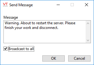

The Send Message dialog:
Select a connection before clicking the Send Message button to send that message to only one connection. Check the Broadcast to all box to send the message to all connections.
