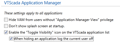

- Open the Application Configuration dialog.
- Select the Edit Properties page.
- Open the Other tab of the Edit Properties page.
- Select the option to Enable the Toggle Visibility icon.
The option to log the current user off automatically is selected by default, and is recommended for most situations. If not selected, then the current user will remain logged on until the automatic logoff time is reached. Until then, anyone may click the application's Show button in the VAM and operate the application as the logged on user.
