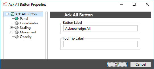

The properties dialog for the Ack All button:
Button Label
Enter the text you want to display. Labels should be clear but short, as the length of the label determines the size of the button.
If the label is to include an ampersand (&), enter two ampersands (&&).
Tool Tips Label
Enter the text that you want to display on this button's tool tip (which opens when the mouse pointer is rested on this button).
