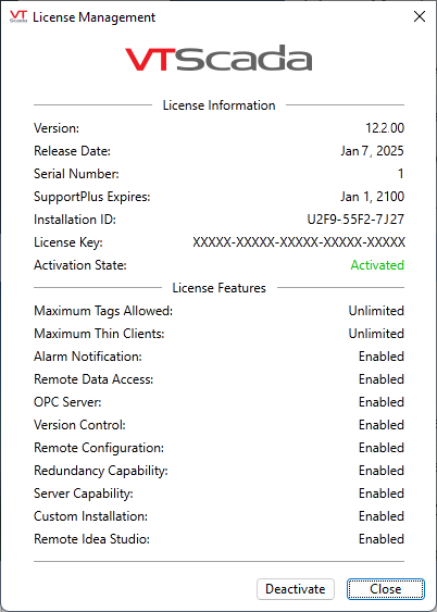

VTScada is distributed as a single installation file. There are no extra modules to be added. Your VTScada license key, a 25-character code, controls which features are enabled. Click the About VTScada icon in the VTScada Application Manager to discover what is enabled under your current license.
