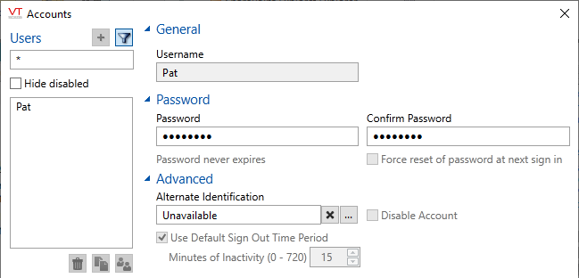

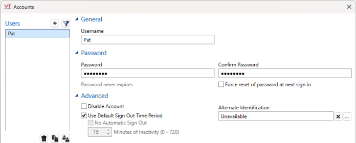

Security options, as seen by an operator with the Account View privilege
- Click the My Account option. The Account dialog opens.
You may view your account settings, but change only your password and Alternate ID with the Account Modify privilege
- Enter your new password in the New Password field.
 - Enter the same password in the Confirm Password field.
 - Click OK.
If the password you have entered matches in both fields, the new password is saved to your user account.
