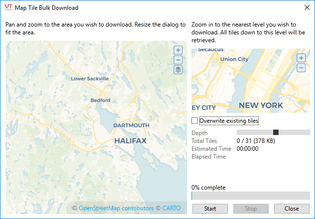

Controls within the Bulk Download dialog
- The larger map (to the left) defines the area for which tiles will be downloaded.
- The smaller map (to the right) defines the zoom level.
While not displayed numerically, zoom levels range from 2 (far) to 18 (near). The zoom level of this map must always be greater than or equal to the zoom level of the area selection map.
(New York was chosen for the focus of this map because it contains detail down to the nearest zoom level, which may not be the case in your selected area. This does not affect the area for which you will be downloading tiles.) - Tiles will be downloaded for the entire area in the larger window, for all zoom levels from that shown in the area selection map down to that shown in the zoom level map.
- The depth bar indicates the range of zoom levels that will be included, where the furthest zoom level (2) is to the left and the nearest (18) is to the right.
- You can resize the Bulk Download dialog as needed to match the area selection window to the area of the map you are interested in.
- The display of Total Tiles tells you the number and disk space required. The estimated time will update during the download.

The Bulk Download dialog opens. - Use the larger map (left window) to define the area for which tiles will be downloaded.
Resize the overall dialog box as required so that the larger map shows only the area you need. - Use the smaller map (right window) to define the zoom level to which tiles will be downloaded.
- Review the information displayed beside Total Tiles.
- Chose whether to overwrite existing tiles (refreshing the view if newer tiles are available) or not (reducing the time required for the download).
- Click the Start button.
You may click Stop at any time to cancel the download.
