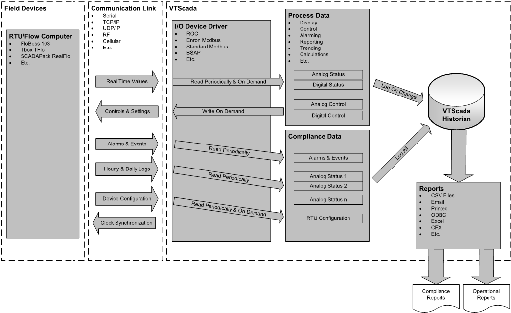

The following figure shows how the Flow Computer meets these requirements.
Key points shown in this figure include:
- A common I/O driver is used within VTScada for both operational process values and compliance reporting data.
- For each I/O device (flow computer or RTU), the driver can use communication link options that include direct serial, TCP/IP, UDP/IP, cellular, TCP/IP to serial, etc.
Multiple field I/O devices can use the same link, or multiple links can be deployed easily in a single application. - Tags that collect compliance data are built automatically based on the field I/O device in use. These tags log all collected data to the VTScada Historian, automatically on data change, using the same format that it is received from the I/O device. No scaling calculations or other manipulations are performed on the received data values.
- SCADA system developers use standard VTScada tags to monitor process data. These tags are used to build the displays that operators use to interact with the process and can include standard VTScada tools for visualization and control, along with custom calculations to meet application specific needs.
- The VTScada reporting engine is used to generate reports from the Historian. These can be tailor-made to the end user’s requirements.
The Oil & Gas Solutions layer contains a number of reports specifically designed as industry compliance reports (CFX files for example) but all logged data, including process and compliance values, is readily available using a number of built-in VTScada report types.
All Historian data is also available via the VTScada ODBC driver for report generation using 3 rd party reporting tools.
